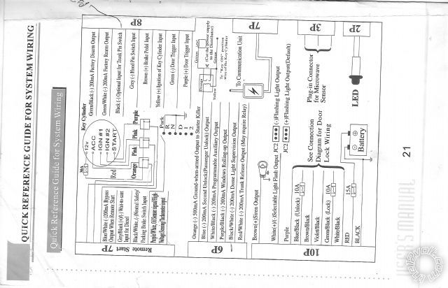

I have a 2005 Nissan Titan,finally got all bugs worked out..Last thing is remote start.The engine does crank but not start..That the instructions for my model.I have connected,read to green(12v constant)orange to red (acc wire)pink to brown(starter wire) pink to lt green( 2nd ignition wire)purple to BLACK/ red (ignition wire)I also have an omega imo 520 interface connected,any help would be appreciated.

Are you running W2W from the remote starter to the IMO-520?  I am not familiar with your remote start unit.  According to DEI, the
RF bypass section only works in D2D mode.  Not sure on this because I have never used an XK520 / IMO-520
2005 Nissan Titan: XK520 - NISSDL 3.02
 W2W
AV-Domelight Activation
DL-Arm Factory Security
DL-Disarm Factory Security
DL-Door Lock Control
DL-Door Unlock
DL-Trunk / Hatch Release
 D2D
DL-Door Unlock
FOB-Control of aftermarket alarm with OEM remote
PK-Universal RF Bypass- Key Req'd
SS-CAN Alarm control w/ FOB remote
ST-Door Lock Status
As for your ignition wiring, looks like you will need some relays.
Bulldog lists two Starter wires that must be powered.  They also list two ACC wires and only one IGN.
 12 VOLT CONSTANT                            GREEN (+)                                                                                     IGNITION SWITCH HARNESS
 STARTER                                                 BROWN (+)                         See NOTE *1                                  IGNITION SWITCH HARNESS
 STARTER 2                                              LIGHT GREEN (+) or BLUE/GREEN (+) See NOTE *1        IGNITION SWITCH HARNESS
 IGNITION 1                                               BLACK/ RED (+)                                                                           IGNITION SWITCH HARNESS
 ACCESSORY /HEATER BLOWER 1     RED (+)                                                                                        IGNITION SWITCH HARNESS
 ACCESSORY /HEATER BLOWER 2     PURPLE (+)                                                                                IGNITION SWITCH HARNESS
NOTE *1 When Installing a REMOTE STARTER, you MUST use BOTH Starter #1 and Starter #2 wires. Both wires must be
                 connected to the STARTER/CRANKING Output wire from the Remote Starter or the vehcile will NOT Remote Start
                 when the Engine is cold.
DEI has the same info:
12volts                           green (40A)  +                            ignition switch, white 6 pin plug, pin 3
Starter                            brown  +                                      ignition switch, white 6 pin plug, pin 2
Second Starter             lt. green or blue/green  +         ignition switch, white 6 pin plug, pin 6
Ignition                          BLACK/ red  +                                 ignition switch, white 6 pin plug, pin 1
Accessory                     red  +                                           ignition switch, white 6 pin plug, pin 4
Second Accessory      purple  +                                     ignition switch, white 6 pin plug, pin 5
