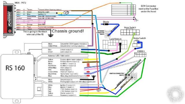

Here is my setup https://i1113.photobucket.com /albums/k501/Syn664 /Untitled-1.jpg
I have a diode on the Keysense blue wire. and there is a typo on the parking switch (it says keysense)
I am not sure which is the remote starts 200mA status output. is that the black "ground for OEM bypass modeule -)? If i connect the brown GWR to the black ground for OEM and then connect the XK05's loose black wire to a chassis, will i get better luck?

The Black Ground for bypass is just a constant ground.  It can be connected to the bypass Black wire.  The Violet/White Ground When Running wire goes to both the bypass Brown wire and the cars' Keysense wire with diode isolation.  (Keysense is only necessary if you have the Toyota Factory Alarm system.)  Typically I connect the XK05s' Red wire to the RS160 thick Red +12V Battery wire and the XK05s' Black ground to the RS160s' Black Ground Input wire ( next to the White Parking Light wire ).

Ah ok. It looks like everything in my diagram is correct then. I have the brown going to violet/white and those go to a diode which goes to the keysense. I cannot find any problems in my diagram. I am completely out of ideas....

Everything looks good.  Does the bypass program as per the install guide?  Where does it differ / fail ?
Are you sure the XK05 has the PKT2 firmware loaded on it?  I would re-flash the XK05 module and try again.
Also, is this an 80 Bit key?  Is there a "G" stamped on the blade?  If not you could try the XK05 with the 5.PKTI firmware.  It is an easier install with all the connections at the ignition switch in the steering column.
