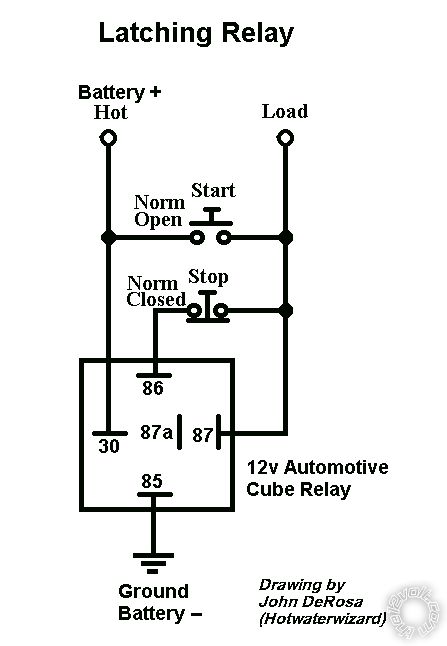

single positive pulse to constant on/off? -- posted image.

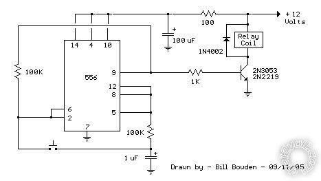

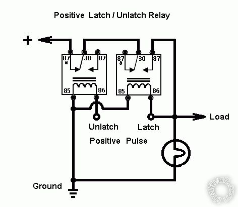

But that's 2 buttons!
Otherwise I would have provided the normal SPST latching relay wiring.
(It can follow the input power, else an optional switche to engage, or an optional switch to break. The same topology as your SCR diagram except with an SPST relay...)
POST EDIT - the same as your 2nd diagram with a single relay; though I include diodes towards 86 to prevent cross-powering (instead of the otherwise redundant relay in the last 2-relay version).
That circuit is often used to limit switches - eg, water level systems.

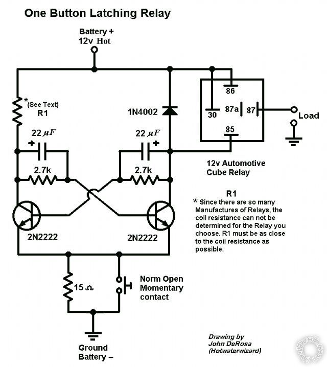

Oh wow lol... I was thinking more along the lines of a mechanical latching relay!
oldspark
Gold - Posts: 4,913
Joined: November 03, 2008
Posted: December 21, 2010 at 2:58 AM / IP Logged
The problem is the single input/switch.
Two switches is easy.
