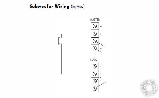

    also when i do run master slave tou have to hook the wires up really weird to me heres a pic of what im talking bout
    sub enclosure, amp wiring -- posted image.
    the manual will explane im sure. sorry to be so dumb but ive done stereos for 6 years and still when it gets done to it i still need alot of help, really i just need a pic of a wiring diagram to go by for the best results for sound. should i use just one amp?

    Take that diagram above ^^^
    Wire your amplifiers as instructed to strap them.
    Where you see the one woofer, that is "your load". Here is where you connect your woofers; you will wire your four voice coils to a 4-ohm load (series-parallel). Follow the instructions here... Use option 2.
    Your total output will be in the 1600W range, (1600 DIRECTED watts... meaning - take that power specification with a pretty big grain of salt) providing your woofers with around 400 watts each.
    That's all you got. :)

    haemphyst wrote:
    First of all, MAXIMUM LOAD (or if you prefer, minimum impedance) is not necessarily "optimal". In fact, it is decidedly NON-optimal. Inefficient, poor damping, higher distortion...
    YOU CANNOT GET, NOR DO YOU NECESSARILY WANT 1-OHM! For your amplifiers to "see" 1-ohm, you have to strap the amps across a 2-ohm load, which you cannot have. You have two 4-ohm DVC woofers. 1-ohm, 4-ohms and 16-ohms. Those are the net impedances available to you. In strapped mode, connected to a 4-ohm load, your amplifiers will be loaded to the equivalent of 2-ohms per amp.
    Connected to the 4-ohm load, there will be LESS than 3dB difference in output (referenced to a 2-ohm load, which you cannot achieve with two 4-ohm DVC woofers), and you cannot hear that. Are you competing? Then don't worry about it. You are already going to be providing your 500W woofers with 600 to 800W each (not the 400W I previously mentioned - that was my bad). You will have plenty of power.

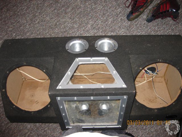

    now my question is i just got this old box that holds three subs (12s)
    and i want to use it but im not thinking it is gonna be enough cubic feet. the box is sealed on each end and is a bandpass in the center.
    the box is a m.a. audio mbbp12 and im not sure of the specs its 14 inches on bottom (from front to back) 15 inches on back (from bottom to top) 42 inches long im not really sure if u ask me for a spec. mes. then i can post it.
