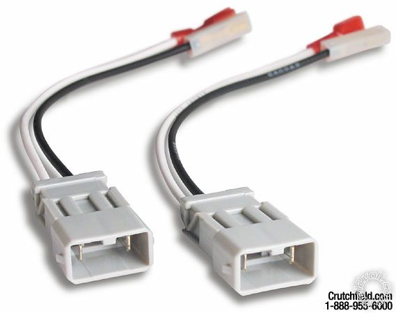

trying to install front and back speakers in a honda insight 2010 and cant find anywhere the speaker wire color codes and need to know which ones positive and which ones negative.. if anyone can help that would be awesome.

what wire colors do you have or see and where are you getting them, at the speakers themselves?

If the stock speakers have connectors like these then you should be able to tell by comparing the orientation of the plug and the wires(white is positive) these adapters say Honda/Acura 1990 and up
