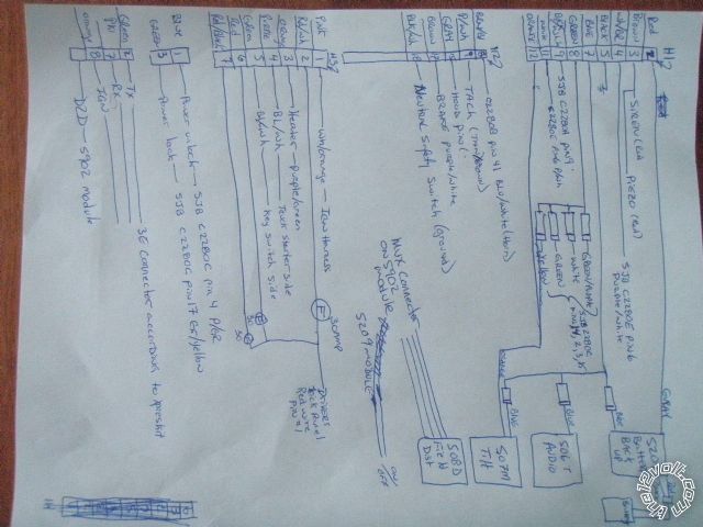

triggers are negative, added quick wiring sketch
09 f150, viper 5902 issues -- posted image.

just realised i forgot to add the red power from the 506 and 507, they are connected together and go to the gray of the 520 back up battery.and the black of the 506t  goes to H1/5 common ground

in my previous post with the attachment, i forgot to show
1) the 506, 507, and 520 black connect together and go to the H1/5 which goes to the negative of the battery.
2) the 506,507, and 520 red connect together and go to a +12volt constant i brought in from battery.
