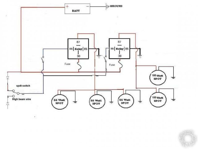

As you can see i already put 2 Diode on the circuit to prevent the circuit to overlap when the switch is used.
