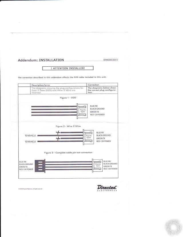

hi guys  im  glad to have you  all here  anytime to help us ,im having  an issue with dlpk module , i do not know which wire should be power 12 volt ,if it will be the blue wire or the red wire , i dont know if the (xpresskit) fix it ,or not yet, yes i have the manual sayng to wire as 12 volt ,blue wire ,but also i have a note came with it sayng exacly this
dlpk -- posted image.

go by the pin out. they will never be next to eachother. black will always be ground on them.
