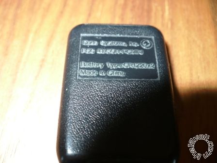

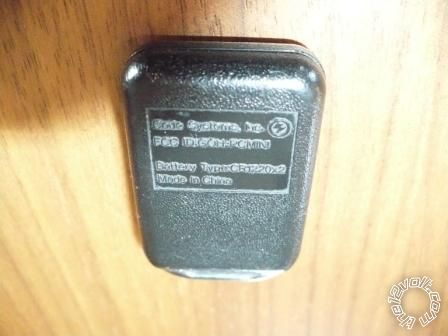

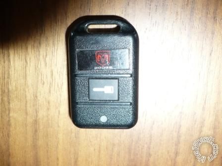

Okay, here's some pics of what is apparently a remote fob made by Code Systems Inc. See there's a Dodge logo on the front but I guess it's what you'd call "factory aftermarket"? Anyway, FCC ID # is GOH-PCMINI if that helps anybody out sorry, I have a pretty crappy camera eh!
remote start timer function -- posted image.

Okay guys, problem solved!!! I was able to access the Code Systems Tech Services web page and found an installation manual for their MOPAR remote start systems. The default run time is 10 minutes but it can be programmed for 15 minutes instead. I will do the reprogram and let you know how I make out.

You figured it out before I got back to the thread. Yes, you are correct that is a dealer installed Code Alarm piece branded as Dodge. Let us know how it goes.
