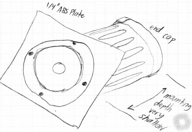

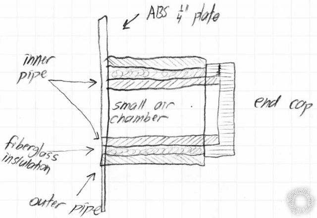

The design starts with a 12" x 12" square of ABS plastic. Mount the speaker onto the panel. Take a piece of PVC pipe with an inside diameter just large enough that it can slide over the backside of the woofer. Cut it down and add an endcap to minimize the total air volume inside it. Great, now you have a very small sealed enclosure that you can mount using the large ABS sheet (which can be trimmed to any shape).
aperiodic concept for midrange in doors -- posted image.

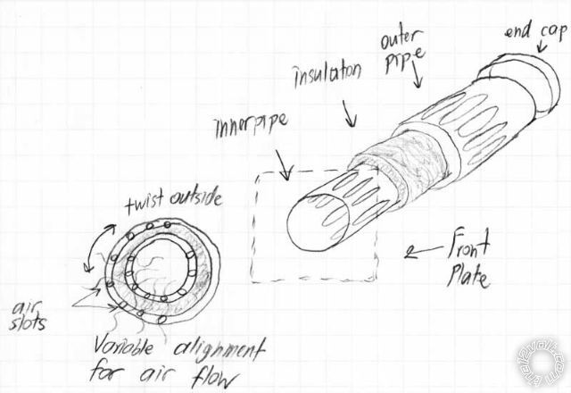

Now take another pipe slightly larger than the first pipe, and slide them together. Choose a size so that there is a decent gap between the tubes. Grab some fiberglass insulation and fill this gap. Now you have a medium inner tube with an endcap, a bunch of insulation wrapped around it, and a larger outer tube sandwiching it all together.
Now disassemble everything. Using whatever tools you can, create lots of slots longwise in both tubes. I'm aiming for a width of 1/4" to 3/8" and as long as possible. Most resources I have found recommend the surface area of the vent should be about 1/2 the surface area of your woofer. So for my 6" woofer (28 sq in.), I should have about 14 sq inches worth of vents.
Notice how if you only drill slots on half or three quarters of the circumference of each tube, you can twist them to vary the amount of air allowed to "leak". Should be a super easy way to tune the aperiodic vent. For more coarse adjustments, of course we can change the amount of fiberglass we stuff in there.
One thing not noted on the drawings is to be sure the ends of the pipes are sealed. The ONLY path from the rear of the woofer to the outside of the enclosure needs to be through the inner slots, through the fiberglass, and then finally through the outer slots. I plan to find some rubber gaskets for this in the plumbing department at the hardware store.

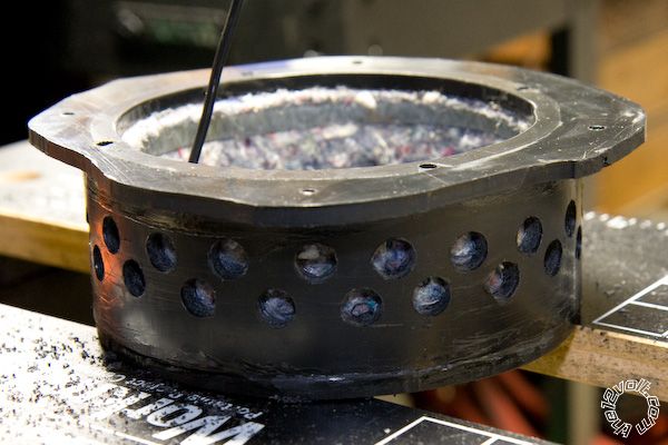

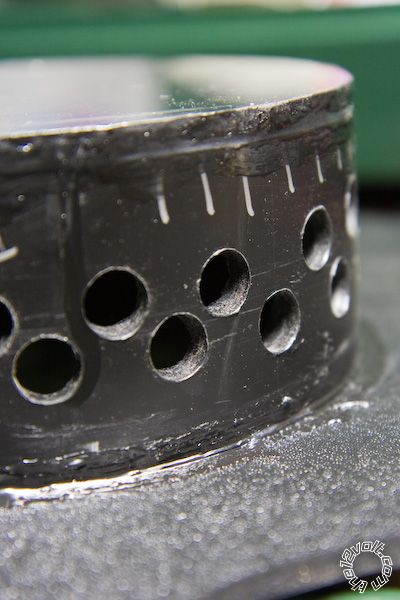

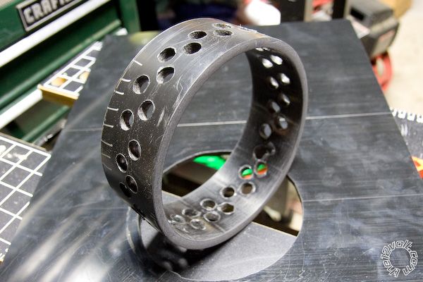

Could not find both 5" dia and 6" dia ABS pipe, so changing the plans a bit. Using only 6" dia pipe now, and drilling holes into the side instead of creating slots (much easier this way). Fiberglass will be on the inside of the 6" pipe, sealed against the holes by thin rings of 6" pipe that have a slit cut in them, so they act like a C-clip pressing the fiberglass against the inside wall of the 6" pipe.

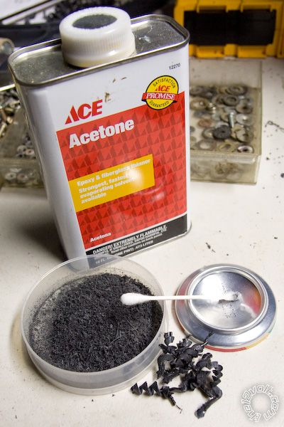

To glue the ABS together, I'm using a sweet technique I found elsewhere. Keep all the fine dust-like shavings created when cutting/sawing/sanding the abs pipe into shape. Then, mix it with a little bit of acetone to create a thick sludge. I find the bottom of a coke can works great for this. Apply the sludge (generously) to both faces you want to "weld" together, and clamp overnight. Working time once you mix the shavings and acetone is at least a few minutes, or until the acetone evaporates. I'm surprised how well this worked, it's like welding with a q-tip !
I'll post some more over the next few days.

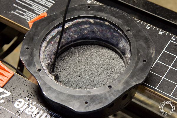

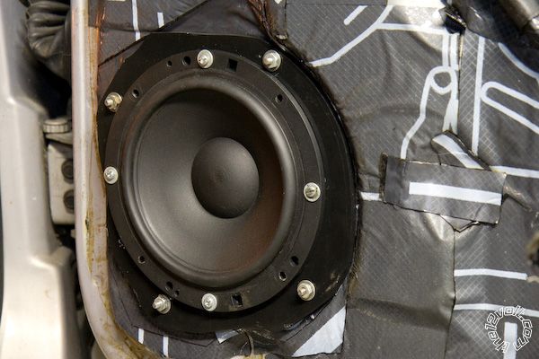

More progress. Instead of fiberglass insulation as a leaky membrane, I'm using some fibrous carpet padding. This is the older-style stuff with many strands of fabric, not the newer plastic-foam-style stuff.
The padding is held in place by a strip of sheet metal along the top edge because the woofer basket needs the clearance. The bottom is held in place by a C-shape section of the 6" pipe that has been trimmed down to size.
Installed in the door, makes for a very tight fit. Cannot comment on performance yet, need to get some sleep first. And yes, that is Grace Water Shield roofing material on the door, don't laugh (okay maybe a little). It's 1/10'th the cost of dynamat or other "professional" products, the adhesive is a thousand times better, it weighs the same, and does not smell like asphalt. I'm using it to seal the door as air-tight as possible, not prevent sound from coming through the door.
