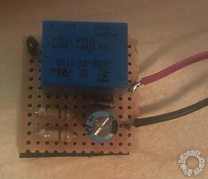

well I'm finally a happy man! I'm not sure where the issue was, but I started from scratch with the new suggested values, 100 uf and 100k ohm, and found while it pulses reliably, the discharging was a bit too slow, somewhere around 25 seconds. I then switched out the resistor on a whim to the also suggested 2 10k's in series, which works a treat and brought the discharge time down to about 3 seconds.
I attempted to make it look presentable with a little bit of perfboard, just for kicks. I won't be showing the back side of it constant to momentary not pulsing -- posted image.
Again, lots of thanks, oldspark!! I don't see this little experiment having gone as cheaply or quickly without your knowledge.

I'm glad you did do it this way rather than the wimp's way (or bad adviser's way LOL!) - who needs a spade-type auto relay??!
Let's face it - yours is smaller, quieter, and more educational. ("Everything is the same, only different." - in this case, coil resistance and drop-pot voltage, hence.....)
I see you are already an expert at matrix board assembly - at least of my standard. (Track-side = censored.)
I reckon it's the board that makes things untidy, hence I omit it. "Free-air bird's nests" might be the common name. (Of the Dove or Pigeon type!) Also quit censorable, else epoxy pottable!
TIP - Never try to tidy up a working bird's nest or transfer to specially designed PCB - the circuit will fail! (IE - If it works, leave it alone!)
