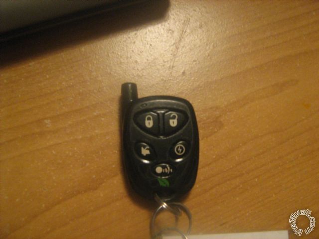

Posted: January 26, 2011 at 11:37 PM / IP Logged
Here is the picture if the remote
remote starter, 2007 pontiac pursuit  -- posted image.
The car is a Pontiac Pursuit 2007
When you say dash panel, do you mean the panel under the stearing wheel?

Posted: January 27, 2011 at 8:24 AM / IP Logged
It doesnt look like anything ive ever seen. i would guess tho that the green is a company logo maybe?
yes the panel under the steering column. remove it and find your ignition harness and trace the wires. there or it may be in the center console. the wires for remote start can also be found at the bcm which is on the passenger side of the console

The number on the back is the FCC ID.  This identifies the transmitter as an AutoStart  product, and the model tested for the FCC ID was the AS-2510TW, a two way LCD remote system--possibly you are looking at the companion remote (1 WAY) or a replacement remote. Many times the FCC report is for a family of products, rather than that specific model--that model may have been representative of the product family offering compatible wth that transmitter.
This is from the operational description from the FCC report:
SYSTEM DESCRIPTION, ASTR2144
The ASTR2144 transmitter is used in a half duplex car starter/alarm system and operates
at 433.920MHz, WBFM. The ASTR2144 is used as the second remote for the 2-Way
system. (1-Way only Remote to Car)
The remote can also be used for a 1-Way system.
 Here is the link to Auto Start....This wil maybe give you  better idea of how the system works.
http://www.autostart.ca/downloads_user_install_guides.php
Also, there should be an antenna on the windshield for this system.  It might be easiest to just trace the wire down to where it feeds under the dash, and find the bran that way.  You may have to remove a dash panel to actually access/see the brain.
