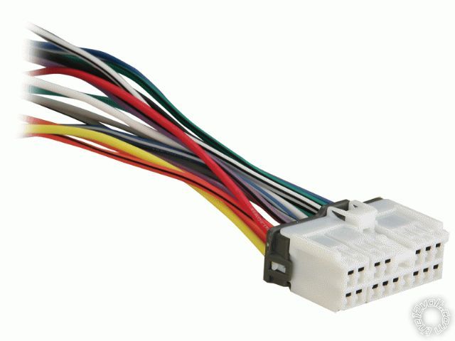

Here's a picture of the vehicle's plug:

According to your picture you need a HY03B by Scosche
Product Page
That above link is the mating connector for THIS which looks like your above picture. Scosche doesn't list your car as compatible, but pictures do not lie identify replacement connector -- posted image.

Following is a picture of a Metra 71-7301 wiring harness.  This is the harness that would plug into the factory radio.  It appears to be exactly what you posted.  The harness you need is a Metra 70-7301, this is the one that would plug into the plug you posted in the picture.

But, huh. This is really weird -- the Metra site shows the ones you listed as being standard for this vehicle. The Scosche site shows the ones like this as for Hyndai Sonata/Accent and a completely different one for Kia. And the plug in my vehicle looks really well-done, no signs of aftermarket modification (that my amateur eye can see).

Update: I called Scosche and they said that if it's a late-model '05, it might use HY07B instead. Now to hassle with an exchange... (Thanks a lot, Kia... identify replacement connector -- posted image. )
