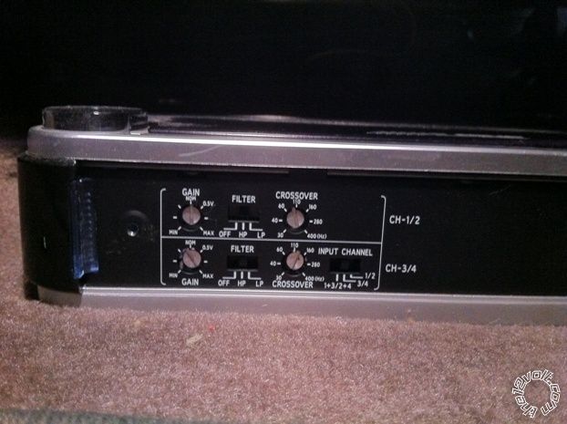

stevdart - look what I found! Took this photo of settings on the amp. Does this lend any insight?
The "Filter" setting, based on what I read in the manual of the PDX4.150, is a crossover mode switch - HP being high pass. It reads: "Set to the "HP" position when the amplifier is used to drive a tweeter/midrange system. The frequencies below the crossover point will be attenuated at 12 dB/octave."
For the dials to the right it says: "Permits adjustment of the crossover frequency, by rotating the knob to select any frequency between 30 to 400 Hz as the crossover point."
FYI there is no subwoofer in my system.

What you're looking at on that amp is the standard 12db / octave active crossover.  You can select either HP or LP on channels 1/2, and same choices on channels 3/4.  Typically, two channels will run front soundstage and the other two channels will power either a sub (by bridging the channels), or a second pair of speakers in the rear.  Either way, the crossover adjustment of "30 to 400 Hz" is typical of the selection range for adjusting between high pass and low pass.  It us usually set at 80 Hz or 100 Hz, but there are sometimes reasons to vary the mark a little lower or higher.
FYI the crossover range from midrange woofer to tweeter is around 3,000 Hz, sometimes up to 5 kHz.  Simple systems such as coaxials use nothing but a small capacitor built directly onto the speaker to filter the range of music that reaches the tweeter.  The mid woofer has no help or limitations on this type.  These types are certainly not nearly as good as separate components with passive crossovers, which contain capacitors, inductors (coils) and usually also resistors.
If there is no passive crossover, then you might be talking about coaxials?  I didn't look up the speaker that is installed in your car, but if the pair have separate woofers and tweeters, follow the wiring from those components and the wires should lead directly to the passive crossover.  The crossover is also wired to the amplifier.  If the passives were left out, I don't know how the tweeters survived or how horrible the system sounded.
Do yourself a favor and read the help sections found on the left side of this page, starting with https://www.the12volt.com/caraudio/caraudio.asp

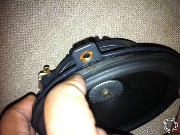

Thanks again for the post. You got me to open up the door and look around inside it to an extent that I had not done previously, and I understand crossovers better than before. So guess what I found?
(1) Wire had worked its way off of the negative terminal of the woofer. Hoo boy!
(2) Stuffed in an odd spot that I never would have seen if I wouldn't have been looking with a flashlight - crossover. Large, rectangular, and wrapped in... duct tape. Yeah, I wasn't expecting to find an audio component dressed up like that.
Mystery solved on that front.
The SL60s are component speakers, separate woofer and tweeter. Now that I've found the crossover, it jibes completely with everything I've read and I understand what I'm dealing with now for wiring.
Here's the rub though - tell me what you think of this. Seems the speaker isn't blown, at least not in the sense I thought. Rather, the backing that connects the surround to the frame is separating from from the metal frame:
replacing blown boston acoustics speaker -- posted image.
If you give the speaker power it works. But at specific low frequencies there is a vibration between the backing and the frame that sounds like a metallic buzz. If you hold the speaker in your hand while it's playing, you can feel it. If you pinch the very edge of the surround and the frame between your fingers, the vibration stops completely.
Given that a replacement set of speakers is going to set me back at least $200, I'm contemplating repair here. Do you think this is repairable with the right adhesive, or is it not worth the trouble?

Repair it and give it a try.  I'd use adhesive caulk to glue it back in.  When it sets up, reinstall it and try it out.  If it plays okay, you may want to take this opportunity to do a little work on those two front doors, by damping the sheet metal with Dynamat or similar, and otherwise taping up and sealing any air gaps you can find.  You would experience a better bass response.

My new best friend second only to stevdart: DAP Kwik Seal Plus Premium Kitchen & Bath Adhesive Sealant, clear, $3.98.
Works like a charm. I will look into the Dynamat. Thanks a ton!!!
