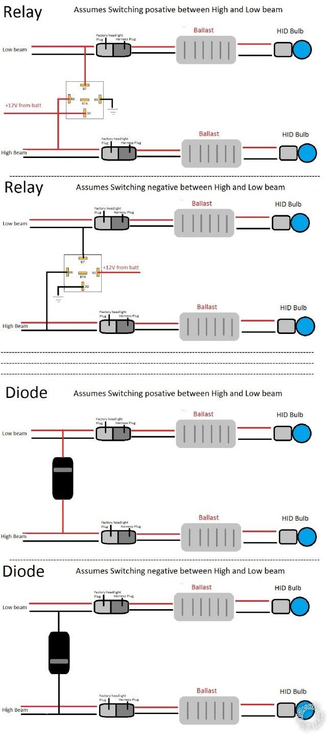

afdanw
Copper - Posts: 74
Joined: August 06, 2010
Posted: February 26, 2011 at 9:39 PM / IP Logged
kstephens1223 wrote:
i have a set of 6000k in both high and low beam, but my high beam conversion wont work, will a heavy duty harness to the battery give it enough power to run them both?
I had this exact same issue on my 02 saturn.  I will draw up a, "how to," so that you  can make the HIDs work, and keep the low beams on when the high beams are active, and the high beams turn off with the low beams are active.  It is pretty simple.  It is one relay.  I will post the picture of the ,"how to," when i have it finished for you.

afdanw
Copper - Posts: 74
Posted: February 26, 2011 at 10:35 PM / IP Logged
I drew 4 options. only 2 will be useable for you based on how your car is wired from the factory.  The best option will be the relay option.  The other option is to use a diod, but with the diode, you will have to find high current (about 20amp) diods, and you still may have current issues.  The realy is a better option.  I hope this helps.

kstephens1223
Member - Posts: 6
Joined: November 18, 2010
Posted: February 27, 2011 at 12:03 AM / IP Logged
thanks alot, i will try it tomorrow, but i dont know if it is positive or negative switched, will it mess anything up if i hook it up wrong?

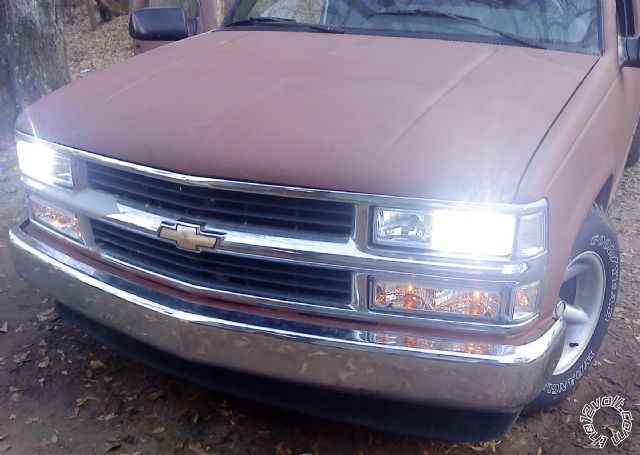

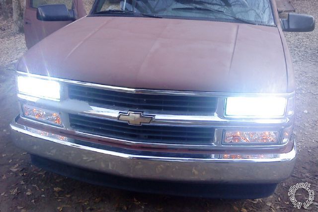

kstephens1223
Member - Posts: 6
Posted: February 27, 2011 at 6:12 PM / IP Logged
hey thanks alot man, works great, and it was positive switch

afdanw
Copper - Posts: 74
Posted: February 27, 2011 at 8:38 PM / IP Logged
Good stuff man.  Glad it helped.  I figured it was most likely the posative switch, most cars are.  My saturn is the only one i have ever seen that was a negative switch.  Looks good.  enjoy blinding the entire road with your high beams.
