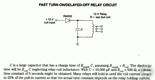

i've been looking for a specific relay config but i cant find it, i think the closest one i see to what i need is the ''Pulsed to Steady Output (Turn signal output to steady output for duration of turn signal)'' threat, but still confused!!
This is what happens, i have a automatic window module but it wont work because the negative pulse from the alarm is not long enough in order for the automatic window module to perceive... it needs at least 0.4 seconds negitve signal, (timed using the truck's body ground) now, i found out there is a 555 something delay relay that would do the job, however i am in mexico in a small community and i can not buy stuff like that here... but i can get capacitors and relays no prob. So PLEASE if can help me with this i will apreciate very much.
Best regard to all members!!

I am using the factory alarm of a 2003 ford pick up lobo and in deed i tried to hook the window module to the keyless lock signal, (the one that is too quick-too short). at the moment is workin attached to the interior light door signal, so every time i get off the truck and close the door the windows roll up, which is not so bad, is actually workin pretty good!
however i would love to hook it properly to the keyless lock sistem.
And there is where i need to make that pulse signal last a bit longer!!!
Regards.

Use this circuit with a 1000 uF Capacitor

Thanks Hotwaterwizard will try that one, seems it would work.
will let you all know!

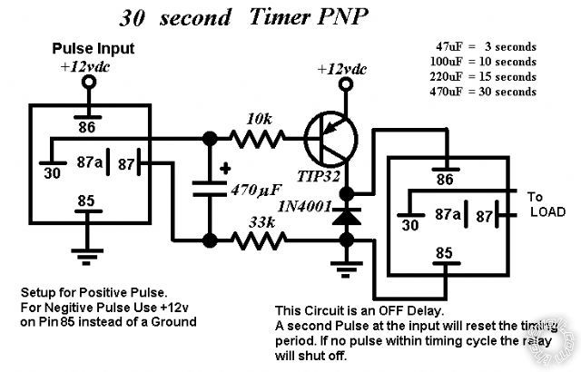

You can get a longer delay if you use transistors.

Thanks sooooo much hotwaterwizard!!!!
I havent got the time to try them yet, been very busy at work, however you be sure i will do!!!
those parts are cheaper here in mexico! lol
