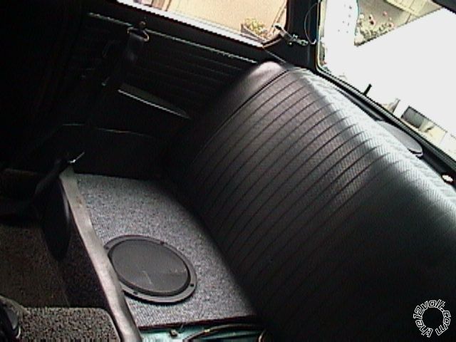

I have seen people putting 6x9s into the panel below the back seats, here is an example of this:
need advice on proposed 1st system -- posted image.
in the pic you can see that he has put 2 6x9s and a 10" sub into this area. I am not wild about putting a seat cover over a 10" sub for a lot of reasons so I am going to put 6.5"s where he has his 6x9s. I reckon this mid-range from a 2-way speaker is wasted at this height - since bass is more omnidirectional having the bass down low in the car should work fine.

I got the picture from Google.
Some mid bass woofers or small sub-woofers will work fine were those 6x9's are. I would build enclosures for what ever you pick so you can get the most out of them.
