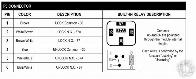

astrostart rss 5224 and 93 fleetwood -- posted image.astrostart rss 5224 and 93 fleetwood -- posted image.
thats my P3 built in relay and i used that setup of Neg2 Pos.
but im not getting any action from the locks.
all of my locks work when using the switch on the doors and keys.

did i wire the relays correctly?
