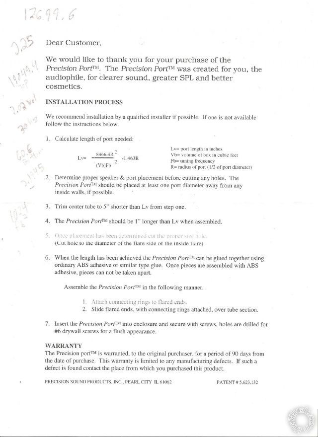

Okay, so the paper that i got with my 3" flared ports has a formula on it and i run the formula, and it comes up with a different number than what the psp calculator gives me. Which should i trust? andyone have a formula, not another calculator for aero ports? I have uploaded a picture of my paper with the formula on it. Do not pay attention to the numbers ive written, those were for a different box. If u need any more specs of anything, lemme know. BTW, the subs are treo ssi 12.22s. they will be going in a box approx 2.86 gross volume. I am looking to tune to 28hz.flared ports confusion -- posted image.

In general port length calculators assume straight squared-off ends.  Flared ports are measured differently because of the exponential nature of the flare, and if they are flared on both ends it's different than if they flare on one end.  I really can't read your notes on the scanned paper but bottom line is I suggest you follow the manufacturer's recommended method for determining the proper length of the port you purchased.

Okay so i figured it out finally. There is a subtraction sign between the division part and the end of the equation. Thought it was a photocopy artifact lol. So, this leads me to my next question however. Is a 3" port tuned to 28 hz big enough for a treo ssi? The net volume is 2.65 ft^3. I am also wondering when i go to calculate my net volume, I have compensated for the sub but now how do i compensate for the volume of the port in the box? If the port is already set length, when i compensate for the volume of it, wont it change my tuning frequency, thus making change the length again, and then a paradox forms? LOL i'm a lil confused on that part.
