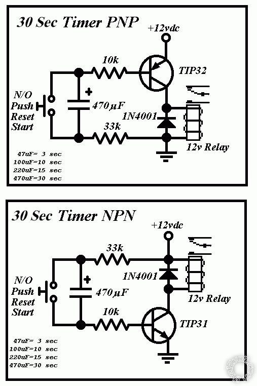

hotwaterwizard
Silver - Posts: 1,350
Joined: December 11, 2003
Posted: April 06, 2011 at 1:13 AM / IP Logged
3 second delay -- posted image.
