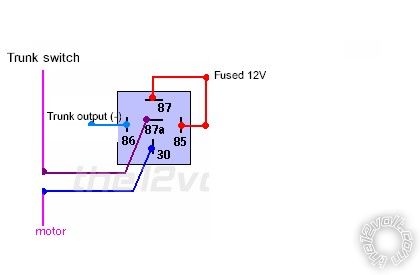

Trunk Release - GREEN / WHITE- In driver'Green kick panel 43 pin plug
*Trunk release is reversal and will require the use of a relay*

On the 2004, the parking brake wire is YELLOW /GREEN (-) at park brake switch....it might be the same color.
Your relay for the trunk
compustar cm 3000 -- posted image.

Got all the functions working.  The last thing I need to do is the trunk.  Thanks for the help!
