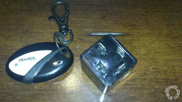

daawuud25
Member - Posts: 9
Joined: October 14, 2009
Posted: April 14, 2011 at 11:23 PM / IP Logged
masterlock sentry kill switch -- posted image.
Other than one other key pad this is all that is in the box other than a paper copy of the instructions I gave the link to... wait there is one more paper with a long list of vechiles this applications just plug and plays in basically, but yeap guys, mines not there... and yes KPierson u can use the pad manually or it can be set to auto detect a person with it... it would be a very cool add to a car that uses no key.... any suggestions

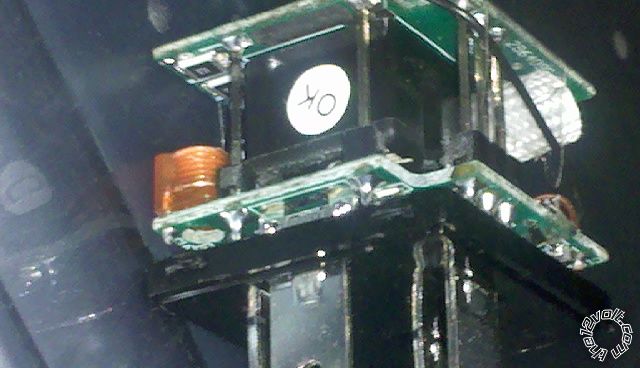

Twelvolt: If i submit a few pics of the relay opened do you thing you can help, cause honestly man i don't really know what im looking at...

Even if I can't there are a ton of very talented people on here that should be able to help. Yes, post some pics.

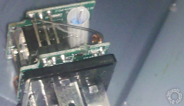

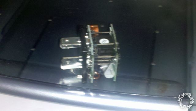

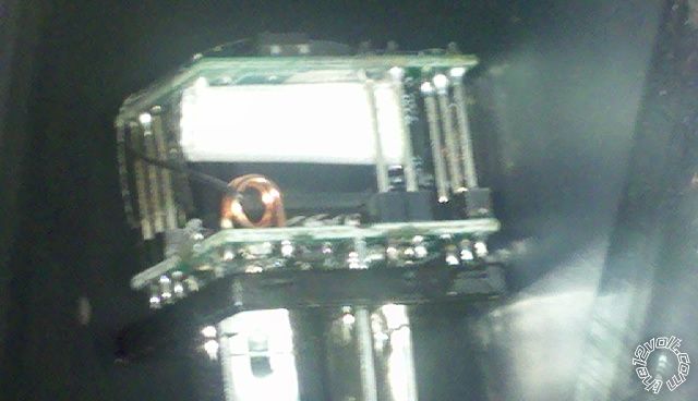

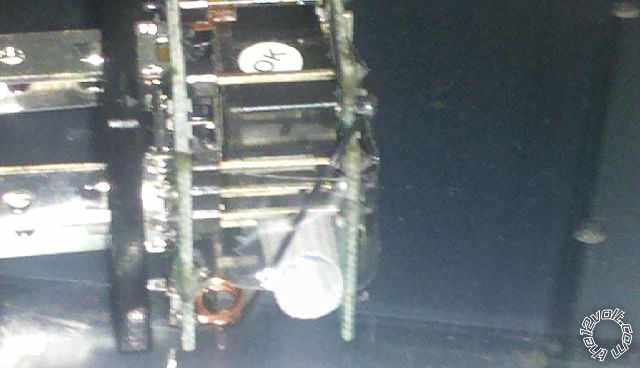

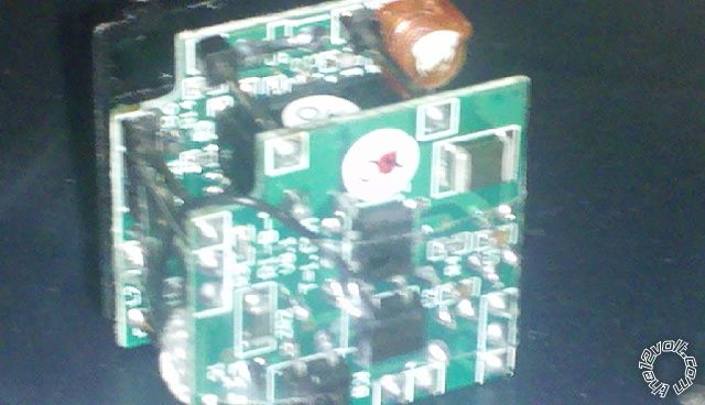

daawuud25
Member - Posts: 9
Posted: April 22, 2011 at 11:54 PM / IP Logged
I don't know if this wil help and if these don't help at all tell me please what would
