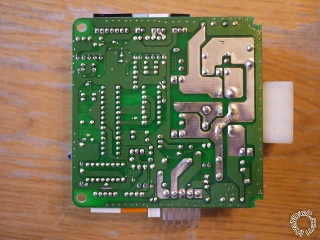

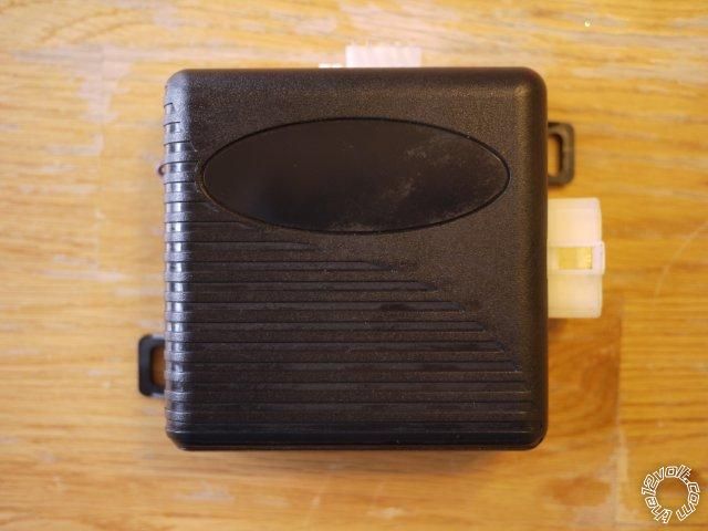

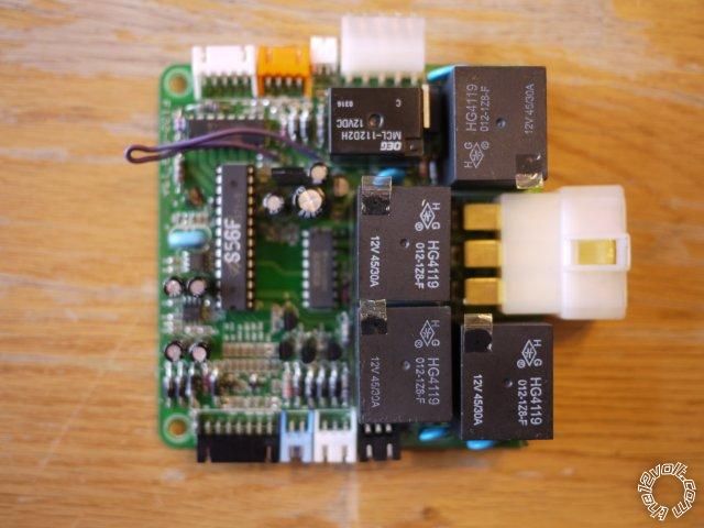

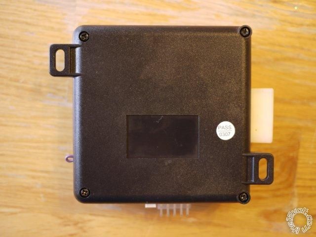

I just purchased a 2002 Galant for my daughter that has an aftermarket alarm/remote starter installed. It is acting erratically (alarm goes off while driving) and I would like to repair or remove. I can't find any names or numbers on the alarm. There is also a 555U bypass installed. Can anyone identify the alarm so I can find the installation and operating manuals? Thanks!

Thanks for the replies guys. I already checked all of the splices. They were all very good solder joints. I replaced the fuses, just in case one had an intermittent break. The problem still happens, so often that I had to disconnect the siren. The FCC ID on the remotes came up empty on the FCC website, but it did lead me to replacement remotes which specified which alarms they work with. I finally identified it as a Viking VS3425 or similar re-brand. It was easy to find the install/operating manual. If I can't find the problem soon, I'm ripping it out...
