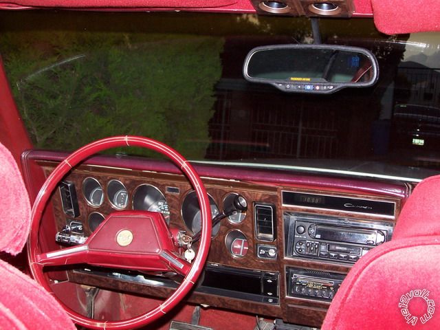

This is the pinout that works with your mirror, here's a 1981 Chrysler Cordoba with the same GNTX-261 working.
Advice for gentex mirror project? -- posted image.
Pin 1.- -----
Pin 2.- -----
Pin 3.- Air Bag On * option
Pin 4.- Air Bag Off * option
Pin 5.- -----
Pin 6.- Temp Probe
Pin 7.- Temp Probe
Pin 8.- Ground (-)
Pin 9.- Reverse Dim Inhibit (Reverse Light Bulb +12v)* option
Pin10.- -----
Pin11.- -----
Pin12.- -----
Pin13.- +12 volts (power switch)
Pin14.- Green LED On Star signal * option
Pin15.- Red LED On Star signal   * option
Pin16.- -----
Greetings from Mexico.
