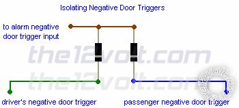

I am looking to do the ol' diode isolation trick to stop my dome light playing havoc with the alarm in my 01 Subaru Outback; following along the lines of
door trigger diode isolation -- posted image.
The question I have is...
It looks like I can put the diode any where between the door switch/trigger output and alarm input..
To save pulling my dash apart and trying to find where the guy that installed my alarm hid it, can I put a diode directly behind the door light switch in the pillar of each door jam?

Posted: April 27, 2011 at 2:47 AM / IP Logged
You shouldn't need it so how is your dome light playing havoc?
More likely a faulty door switch.

Posted: April 27, 2011 at 4:18 AM / IP Logged
That car shouldn't give any problems, just wire the door trigger wire to one of the door trigger wires, the use of diodes has nothing to do with it.

Posted: April 27, 2011 at 5:10 AM / IP Logged
Nothing to do with the delay, it's when the factory uses processors and timers to control dome lights amongst many other things, these vehicles, like e.g. Fords use separated feeds from each door, tailgate and hood. They're known generically as body control modules. I did loads of Impies from around that time and had no problems. I suggest your man has taken his door trigger from the dome (courtesy) switched (via the door pins and a timer) rather than one of the door pins which should be adequate on that car. Japanese car manufacturers were very late adopters of these control modules, they got their electrics right in the first place.

Posted: April 27, 2011 at 5:34 AM / IP Logged
Yup, it's just a matter of getting at the triggers before they pass through the processors, and a diode directly behind the doopr pins would make no sense at all.
