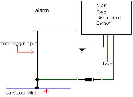

Well, can someone tell me if this diagram is correct? I was going to connect the green wire of the sensor to the door trigger input wire. I was also going to put a diode on that sensor's wire, with the stripe facing the sensor. Is this correct? I'm assuming there's no way to get a pre-warn, and then a full blast, since this is only a one-stage device?
THANKS!

Hey CP, don't use the door trigger instead use the hood pin trigger. WHY ? The door will be either a (-) or a (+) trigger and if the diode is not large enough it will feedback into the (-) trigger sensor and end up shorting out the sensor. The 508T is a (-) trigger output so installing the GREEN wire with the diode band facing the hood pin wire will make the diagram work out. Does this make sense ?

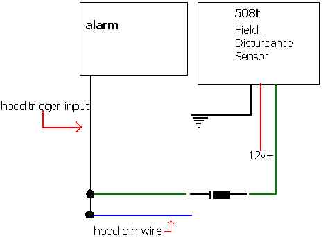

Thank you so much! Here's another diagram just to double check :-) The band on the diode is facing the hoodpin wire so that current won't flow back into the sensor, correct?
As for making this dual-stage with the shock sensor, that's not possible, is it?

Yes, the diagram is correct. You can install the 508T trigger wire to the impact sensor's final trigger wire and it will work. Go here for hookin up the perimeter sensor to the impact sensor. The only thing is you can not use the impact sensors warn away withthis set up.

Thanks Jeff...I would have had the diode going the other way by mistake :-) I'll try it with the hoodpin trigger first. If the full alarm goes off too much, maybe I'll change things around.
Thanks for the help!
