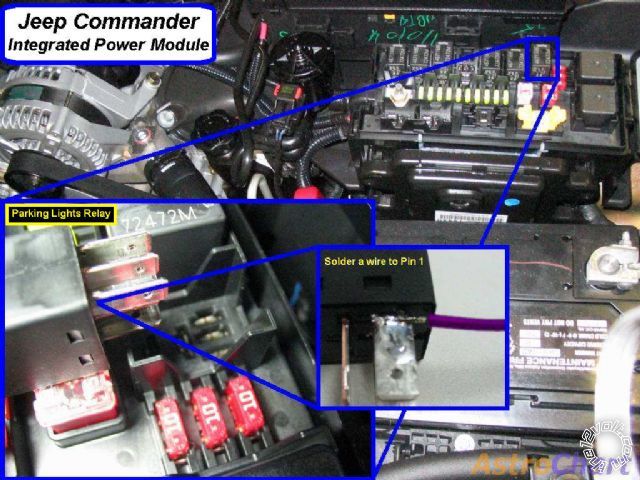

Straight negative at Pin1 of the parking light relay at the IPM under the hood.  To test the connection, remove the relay and test for a ground signal in the relay socket of the IPM when turning on the parking lights. Solder a thin gauge wire to directly to the pin of the relay and you are good to go. You cannot use Positive lights because the relay rests at ground. There is no negative wire in the car because the lights are turned on from the switch via data. We've been doing the "relay" trick sice the 99 jeep cherokee came out.

Sorry for the late response, You will be testing for a negative @ the relay socket with the relay removed. I usually put my red probe on the battery and then test with my black lead in the socket. on the jeeps it is always pin 1, but i always test. I attached a picture of how its done for the older commander. The technique is the same for the newer ones also. Relays need power and ground always to turn on. Haven't seen a mechanical relay with a coil directly triggered by a data signal yet. No matter how complex the circuit is before the relay, the relay will only react to power and ground :)

The relay trick worked, i was using a logic probe and it didnt pick up the change in polarity on pin 1 unless the relay was in its socket. I attached the wire, inserted the relay and it worked correctly as a straight negative trigger. Thanks again for all the help! Hope this helps someone in the future!
