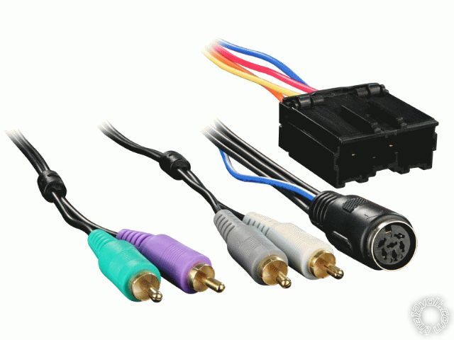

I have used it on an eclipse GSX, The amplifier was under the passenger seat as well. Your Metra harness should look like this:
99 mitsubishi eclipse with infiniti radio -- posted image.

so before i discovered the amp under the passenger seat i used just the standard wiring harness...after discovering that i realized i only need what is in the picture above which the kit came with as well. now that i have it hooked up through the din interface and am using the power adapter i now have plenty of sound coming out of the front but very little coming out of the rear speakers....exact opposite from what i first had. my first thought was maybe a faulty amp? could i wire the rear speakers through the normal speaker outputs? should i bypass the entire amp. to do so do i need to run wires from under the seat to behind the dash. any help would be appreciated. or should i just wire up the rear speakers the way i had them before. since i had rear speaker sound with it wired not through din.
