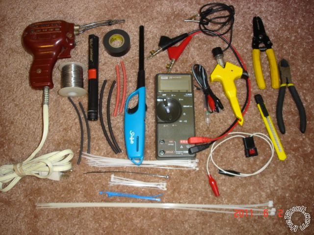

That includes vehicle disassembly; locate & verify all wires; position brain; route, trim to length, solder & insulate wires; program and test; neaten up with wire looms and tie wraps; re-assemble and final test.  Spend time locating a good place in the firewall to pass the Power, Tach and Hood Pin wires thru.  Try to use an existing grommet and apply silicone sealant if required.  Those wires going into the engine compartment need special placement to ensure they are away from heat and movement.
I would pre-wire and set up the necessary relays.  Making those connections "on the bench" is easier than under the dash.  Unused wires can be bundled or trimmed and neatly tied up.
Have your wire listing guides printed out, all compared and highlighted.
Also be familiar with the AutoPage unit & manual and its install sequence.  Some remote start units need to have the remotes programmed first, then use the remotes to set any necessary programming options / features, then a Tach learn, then a remote start.  Some units use the Parking Lights and horn to aid in programming.
As always, preparation is the key.  Here is a picture of most of the items you should have at the ready.
