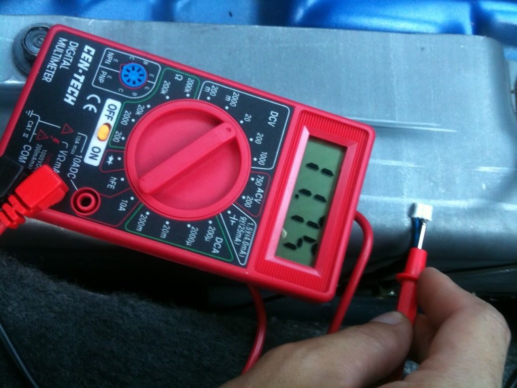

Just took a multimeter and yes the brain is giving off 12v from the mux port, I also took a reading at the plugs where it connects to the 509U and 506T units and they were both getting 12v from the red an blue wires.

509u and 506t stopped working on 5901 -- posted image.
This is the plug that plugs into the 509U unit (both red and blue wire got the same result)
This is the plug that goes into the 506t unit (both red and blue wire got the same result)

The black ground wire may only go to ground when the alarm is enabled, check that, also the green and blue should go to GROUND when the sensors are activated.
Last; you wired correctly but the joined blue and green wires should have had 1N4004 diodes in line with the bands towards the sensors.
All those salient points are in the install guide.
