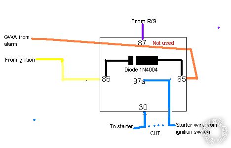

The relay is most likely for the starter kill which I guess is what they are calling the "engine power off circuit." What is the make and model of the system, or do you have a way to upload the diagram.
Posted: June 08, 2011 at 2:43 PM / IP Logged

howie ll wrote:
This helps a lot I think. So basically I just have to connect to 85 (?)

1) How do you know there's a starter cut on the original R/S.
2) Make and model of the original R/S please.
3) From your description of the alarm's starter/ignition* break relay diagram, I would bin it, it sounds like a (Chinese fleabay) POS.
4) Yellow wire on alarm goes to 86, GWA from alarm goes to 85 and don't forget the diode.
5) Clutch switch jumper has nothing to do with a starter cut.
* Don't EVER do an ignition cut it's a real no-no.
