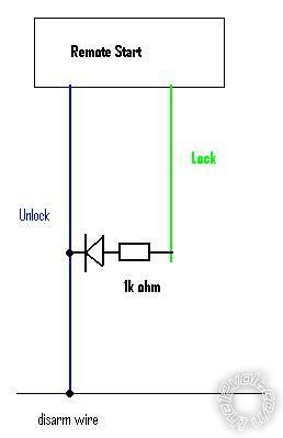

Awesome! Would the diode be like I drew it in the picture? Or since it's a negative pulse do I have it backwards?rx8 keysense as factory alarm disable? -- posted image.

You have it backwards. The stripe goes towards the remote start. You should also put one on the disarm wire, stripe towards the remote start as well
