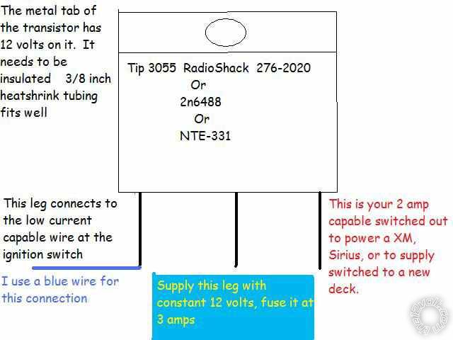

What kind of current is your device demanding from the circuit?  You may need to use a transistor and a relay.  I will look for a post about your problem.
general motors switched power idiocy -- posted image.
Platinum - Posts: 13,726
Posted: July 02, 2011 at 7:54 PM / IP Logged
The above diagram will provide you 2 amps continuous current.  If you need more than that, you need to make the right leg trigger a relay.
