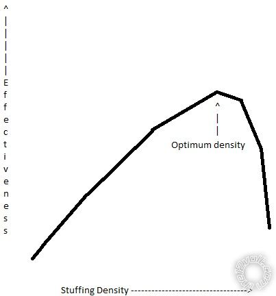

The general rule is .5 pounds per cubic foot.
Even if you DID go to 1 pound per, and you stuffed the whole pound in the existing .75 cubic foot enclosure, you will be overstuffing by 33%, a SIGNIFICANT number. Weight it out carefully, and install the right amount.
There is a curve involved with damping an enclosure, in that there is an effectiveness to the stuffing. There is a peak effectiveness stuffing volume, and beyond this density, your effectiveness drops off rapidly. (See the curve below...) The ONLY way to accurately measure the damping is with an impedance test.
polyfill -- posted image.
The peak density/effectiveness density will ALSO be different, depending on the beginning system Q, the enclosure volume, and the Fs of the beginning system; there is really no hard and fast "rule".
