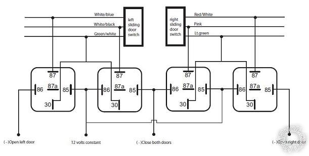

could you help with a 4 relay wiring diagram?

Posted: August 20, 2011 at 11:30 AM / IP Logged
2011 honda odyssey -- posted image.

racerjames76
Silver - Posts: 581
Joined: November 22, 2008
Location: Ohio, United States
Posted: August 20, 2011 at 11:31 AM / IP Logged
That is the 2010 diagram, but it works the same way with different color wires!

Thanks for the quick reply!I'm going back in the garage to wire this up.

Posted: August 20, 2011 at 2:05 PM / IP Logged
I used the 2nd unlock wire for closing the sliding doors.it works great..Thanks a million for your help racerjames76!!!
