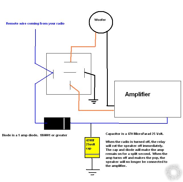

pop from speakers at turn off -- posted image.
Platinum - Posts: 13,726
Posted: July 26, 2011 at 10:30 PM / IP Logged
I do not think you will need the diode and capacitor for your problem, try it with just the relay, if it is still popping, try the diode and capacitor.
Thanks, I have to find my box of relays now!
