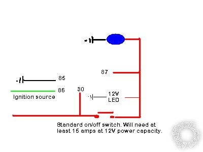

I have a 2000 Excursion, and the power ports have power all the time.  I'd like to add a switch and relay to let me select if it will get power with the ignition circuit or all the time (so I can leave things plugged in to charge and be able to select what ports charge all the time vs only when the ignition is on).
I think I have the wiring down, but I don't know the switch I need.  In the diagram below, the relay would 'activate' every time the ignition is turned on, even if the switch providing the main power to the relay is set to bypass it:
selectable power port -- posted image.
Is there a switch I can use that would only provide power from the fuse panel when the switch is set to send power to the relay, preventing it from activating when it doesn't need to?

All you need, use a 12v green LED, 3mm with holder or a switch with built in LED WARNING , the switch has to have 15 amp capacity at 12volts.
