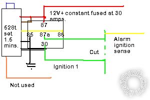

will a 528t work for this application?
offroadzj
Gold - Posts: 2,043
Joined: June 03, 2005
Posted: August 16, 2011 at 1:12 PM / IP Logged
damn... well going back to my current setup, is there any way of "extending" the "ground out when activated" wire of my turbo timer? If I could just get that to last another 1-2 seconds, everything would integrate perfectly.
Thanks for all the help!
Kenny
Owner / Technician
KKD Garage LLC
Albany, NY 12205
Posted: August 16, 2011 at 2:02 PM / IP Logged
This will probably do it but it will occur every time you turn off the ignition.
