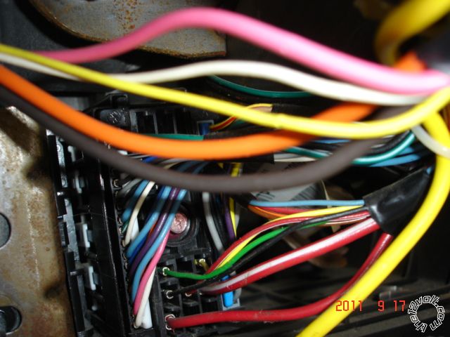

Just did a 2002 Silverado with an Ultra Start last week.  It was a 1500 with the 5.3L V8.  No issues with idle during remote start.

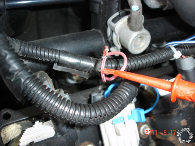

I did run in Tach Mode and connected to a F.I. wire :
remote start rpm fluctuate w heat -- posted image.
There is a connector at the back of the fuse box that has all of the controlled ignition wires.
I added an external relay controlled by the Black AUX1 wire ( reporgrammed to (-) Accessory Output, Menu 1, Item 5, Opt 1 ) for the trucks Brown ACC2 wire.  Both ACC's are very heavy gauge.
I also split the U1272s'  two Red +12V constant wires between the trucks Red and RED / White +12V constant wires shown below.  On the 2003 they might both be Red.

Relay Pin 86 and Pin 87 to +12v constant thru 20A fuse.
Relay Pin 30 to vehicle Brown ACC2 wire.
Relay Pin 87A not used - insulate.
Relay Pin 85 to remote start Black AUX1 wire.

Due to the gauge of the trucks ignition wires, I felt it prudent to split the U1272's load between the two available +12v source wires.  The additional relay for ACC2 was connected to the same source wire as the U1272's Red wire that supplies the starter output.

Think I would connect the U1272 Tach wire to a vehicle Tach source, either the White wire Jim Hunter suggested behind the instrument panel, a F.I. as pictured or the ECM.  You must do a System Reset to the U1272, re-program any non-default options ( with the exception of the selectable relay ) and then start the vehicle with the key.  A successful Tach Learn will give 2 horn beeps and 2 parking light flashes.  Ideally, the engine should be warm and at a normal idle.

Keeping the wire inside the vehicle and out of the engine compartment has its' advantages.  I believe on your model year, you can pop out the vent / parking light control assy at the left of the instrument panel and locate the White Tach wire in a group of wires with some gray tape on them.  Should be the only white wire there but verify with a Digital Multi Meter.  Jim H does  plenty of these trucks and can explain better...
