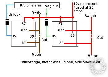

As for the original poster; cut those leads once you found them, then test each side by toggling that passenger door switch. The cut ends that show live on the two are the switch sides.
The diodes are there to protect your K/E from relay on-rush or back voltage shut down spike. Unless your K/E has built in relays*...in which case you won't need external relays anyway, use them, better safe than sorry.
*If you have 6 lock wires you have built in relays and you won't need external relays.
