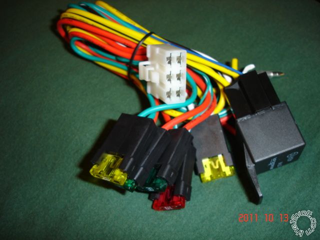

5901 check engine/auto tranny problems -- posted image.
Posted: October 14, 2011 at 2:58 AM / IP Logged
Oh blimey Kregg I need to pontificate sometimes, anyway that loom still follows rule 1
