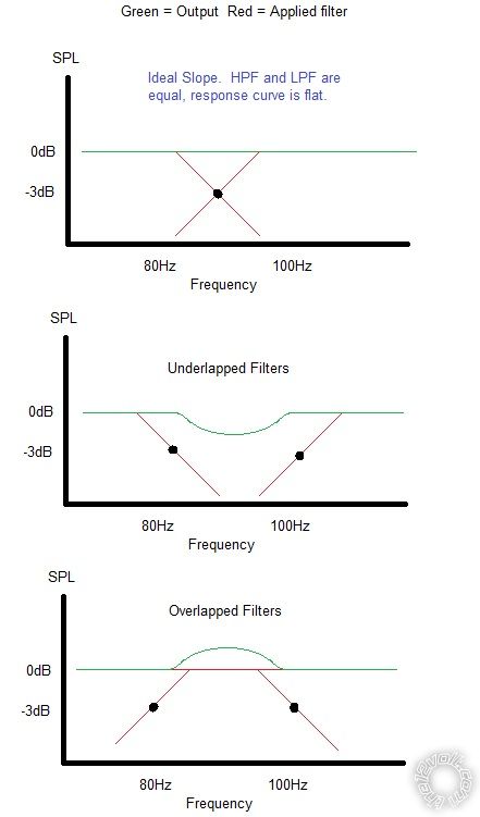

Below I have drawn up what happens when you "overlap" filters, "underlap" filters, and an ideal crossover slope.
x over points -- posted image.

Thank you for the replies. I understand the HPF and LPF being filters, not crossovers, and you want to have them set the same (lpf at 80, hpf at 80), what throws me off is the slope. Having your LPF set at 80, your speaker still plays frequencies above 80hz because of the slope of the filter (or crossover). Is slope normally taken into account, or do you just typically go off of the raw 80hz?

Just go off the 80Hz. The slopes and frequencies SHOULD be the same, so the sound power from the array is flat. Using different slopes will cause the output CURVES shown above (the green lines) to be pulled one way or the other. That's even worse sounding than the nice, uniform humps that are shown. Either way, it's just not OFTEN good. There are exceptions to this blanket statement, but it takes VERY careful planning and placement to make sure that non-symmetrical slopes or filter frequencies applied in a given system sound good. Just generally, DON'T DO IT.

The "100Hz" is the filter frequency. The filter frequency is always -3dB from "reference", or the 0dB line. The order of the crossover simply tells you how fast it filters the frequencies above or below the specified point, in dB per octave. It's how steep the red lines in my example above are. The higher the order, the steeper those lines become, and the closer the "knee" frequencies get.
