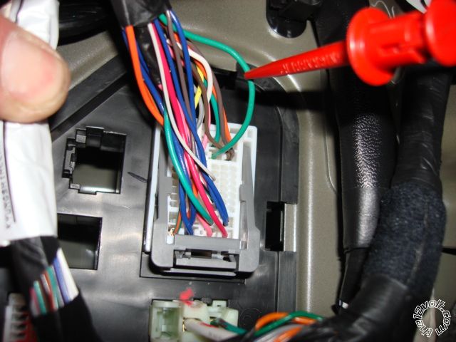

I am installing python 1401 and idatalink ads-al-ca on the 2011 sonata.
Here is the problem. 2011 sonata with smartkey has 2 brake lines.
The installation manual says I have to connect a brake line but there are 2 brake lines.
Do I have to connect both of the lines? or just one
help.
minjunkim
lectricguy
Copper - Posts: 359
Joined: March 18, 2008
Location: Rhode Island, United States
Posted: November 09, 2011 at 4:14 PM / IP Logged
You need to test the wires.  The proper wire should have 12V on it when the brake is depressed, and no voltage when the brake is not depressed.  The information I have indicates this is a green wire.  If there are multiple wires that test correctly (12V when depressed), only one needs to be hooked up.
Lectric Guy
Platinum - Posts: 7,827
Posted: November 09, 2011 at 6:33 PM / IP Logged
Here is a picture of the (+) Brake wire.  It is in the upper plug in the Drivers Kick Panel.
2011 sonata remote start -- posted image.
Connect to just this wire.
