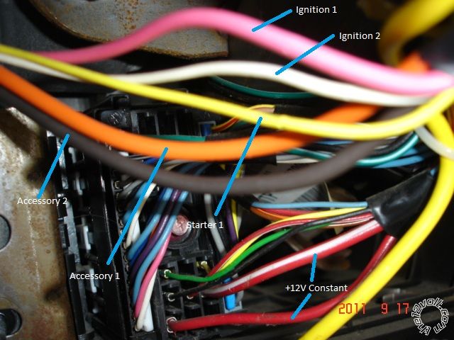

Last question. Can all the 12volt constants go to one of the 40 amp constant lines in the ignition harness or do I need to split them?

Platinum - Posts: 7,828
Posted: November 13, 2011 at 1:01 PM / IP Logged
Can't remember on that model, but many GM vehicles have more than one +12V constant wire in the harness / area.  Here a picture of a 2002 Silverado and while all the guides noted one +12V Red constant, there was a RED / White +12V constant available too.
