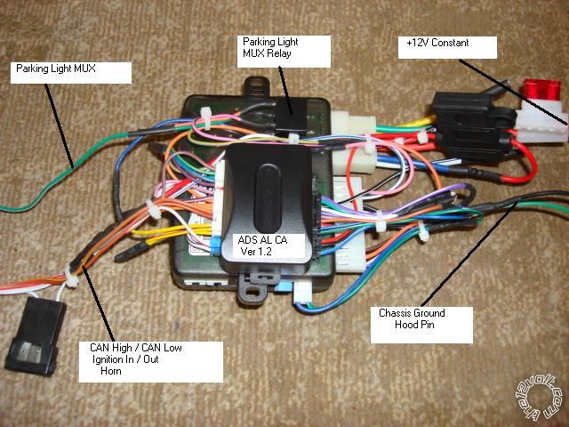

Almost too easy.    ground during crank -- posted image.      Here is the equivalent to your CM6200 + Blade, an Ultra Start + ADS AL-CA module, w/CH4 firmware in W2W mode, all ready to install in Caravan.  Nine wires to connect.
