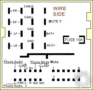

Craig, before the various adaptor leads came along, with externally amplified head units, we did one of three things:-
a) Feed one channel output to an in/under dash speaker, loads of old Nokia and Moto speakers lying around.
b) Go to the amp speaker outputs such as current Lexus IS models.
c) Most Euro head units use a quadplug/most from 2000, it has provision for mute and speaker = & -.
See diagram (might be useful for you):- generic_quadlock.gif
