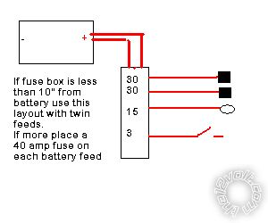

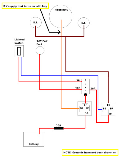

I am adding a fuse panel to my motorcycle to power up some accessories. I understand relays a bit from reading on the web. I already have a relay and fuse box wired into my bike and no switch to my driving lights. I now want to add a switch so I can turn the lights off. I guess my question is, is it acceptable to get the main power for the relay from the fuse panel or should I tap in the the main wire from the battery?

Posted: November 27, 2011 at 5:04 PM / IP Logged
Diagram that I have drawn up
does this look correct? power for relay -- posted image.

Your layout is quite correct.

Thanks for the confirmation. One more question, how big should the relay be that feeds the power to my fuse panel? Should it be more than what amps are being pulled off of the fuse panel? Right now I think I have a 30 amp relay.
Posted: November 27, 2011 at 6:26 PM / IP Logged
You've got me thinking now!
Keep the layout as it is with a 40 amp fuse OR a safer layout:-

I don't understand your diagram. This automotive wiring and relay thing is a new thing for me! Should my fuse running to my relay be of the same size as the relay or should it be bigger? If the relay is a 30 amp, then the fuse off the battery should be 40?
Posted: November 27, 2011 at 6:41 PM / IP Logged
Yes.
In fact since you have 2 relays and the consumer end, driving lights, 2 front and one rear = 30watts = 2.5 amps, add on rush (the surge when you turn on a reactive load) about 7.5 amps.
The headlight on high will draw 55 watts, less than 5 amps so your draw there say 10 amps.
Add 15 amps for the outlet
Total draw including relay coils about 35 amps,use a 40amp fuse and layout, it's quite adequate fro that circuit.
Normal rule is add 1 amp per metre of wire to the fuse rating.
e.g. an amp in the rear rated with a 20 amp on board fuse should have a 25amp fuse at the battery end.
