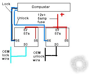

no both wires are (-)
Posted: January 02, 2012 at 1:44 AM / IP Logged
Kreg possibly made a typo, ref. + - meaning only -. I haven't looked but those are the two he meant, feed them to the relays.
Posted: January 02, 2012 at 2:15 AM / IP Logged
