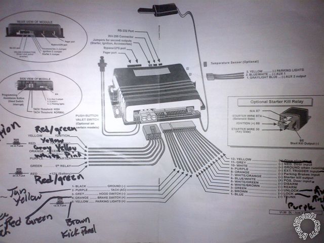

First, thank you very much to both of you, this has given me some new things to try tonight. I will move the jumper to 2nd ignition wire and hook that up as advised. I have attached a picture of the wiring schematic for the Autostart and was hoping you could advise as to which wire might be the Neutral Safety wire. Sorry for the writing all over it but the autostart website isn't working right now and thats all i have.1993 ford tempo remote starter -- posted image.

Try grounding the orange wire (parking brake -), hook up your 2nd ignition and then try again!!!!
I have tried to access AutoStart's website a few time today to review your installation diagram but haven't had any luck. When you push the RS activation button on your remote does your ignition on the car power up at all? Even without the 2nd ignition the other wires should power up, the vehicle just won't start. If the ignition and acessory wires coming from your RS unit don't power up then something is keeping the unit from triggering the event - which would be consistant with either not having the NSS wire grounded.
If grounding the orange wire doesn't work then  make sure your brake input is seeing + all the time, it should only see + when the brake pedal is pushed.

exactly what he said. I would also say the parking brake (-) input is probably being used as the NSS. And like he said, if the ignition is power up in the car then the r/s is activating properly. Otherwise its an input issue with the starter.

I have now grounded the orange wire (slapped my forehead for that one!) but still nothing. When i press the rs button on the remote nothing happens at all in the car, however when i press lock or unlock the lights blink so i know the remote is working and within range. I did check the wire coming from the brake switch and it only sees 12 volt when pressed.

Check your hood pin input and make sure you are NOT getting a ground signal on that wire while trying to remote start. You can also read through the install manual for the starter and see if there is a wire that has anything to do with neutral safety. What does it say by the wire you have crossed out on the top of the list in the bottom right corner of the diagram you posted? Also check the manual for that purple EXT Trigger input and see if that needs to be grounded for start.
