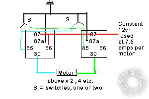

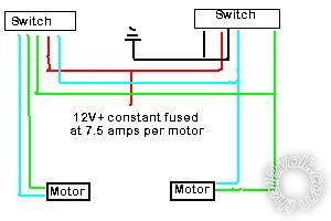

Posted: December 28, 2011 at 6:57 AM / IP Logged
Here are two typical examples, I've no idea which yours might be, my data bases don't go back that far.
